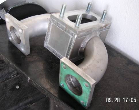

Back to the story.. After pondering at work about a possible carb swap on the Lotus, I went home that evening and started measuring the available space around the intake side of the engine in the Lotus. I also removed the Strombergs and measured their mounting pattern, mounting angle, etc. I then went online and searched the dimensions of the DGV, including the carb’s base mounting pattern. At work the next day (You probably noticed here that I occasionally get a little free time at work) I fired up AutoCAD and started drawing. I played with designs on and off for about two weeks, until I finally came up with a crude design that I felt would be a good prototype. At this point, I sent the design off to Krem Engineering and had Al make me up one out of scrap aluminum. This is basically what I got back (Picture was taken after it had been mocked up and tested, so it’s a little dirty).

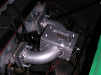

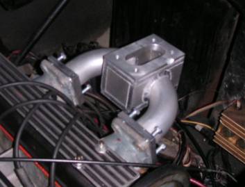

This design proved to be pretty good. I showed that it fit in the engine compartment, and the throttle cable, and fuel lines reached. Below are a couple of pictures of the first test fit.

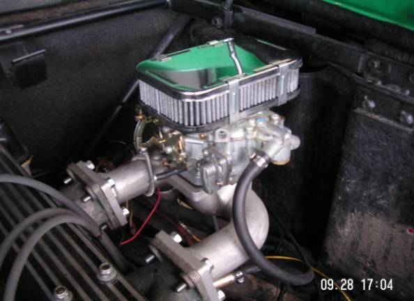

Once I was happy with the fitment and location of the manifold I moved onto the carburetor mounting, throttle linkage, choke linkage, and the air filter. The picture below show the carb on the manifold. Note the throttle lever. This is a modified Toyota Camry circa late ‘80’s piece. Underneath the carb is a 1/8” spacer/insulator.
With this assembly in place, I could verify that it was possible to close the engine cover. So, it was time to mount the carb to the manifold and hook it all up. Unfortunately in my excitement, I didn’t take a picture of the prototype all hooked up.

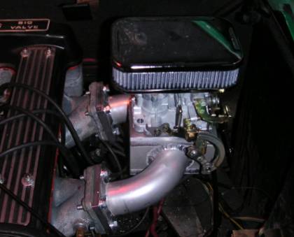

Below is a picture of the finished assembly. The original design had the throttle cable coming across the engine which proved bad as it melted the throttle cable. After fruitlessly trying to insulate the throttle cable, I realized it was possible to rotate the carb on the manifold 180 degrees, and run the throttle cable under the car away from the heat. This also placed the choke actuation in perfect position for the stock choke cable.
So, a DGV does work on a Twink, it runs great, makes good power, and can be returned to Strombergs if required. Also, this carb is easily good for 100,000 miles before needing a rebuild and there is no fire risk as with the plastic fuel fittings on the Strombergs.
