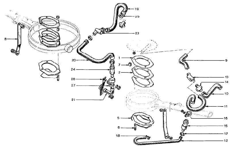

The oil pump only runs when the engine runs. Are you sure you are not hearing the fuel pump? Sounds like a previous owner may have installed an electric fuel pump. :confused:

Fuel pumps make a ticking sound when you switch on, from  memory the older "SU" types were slow/loud whereas the modern Facet I have fitted is quieter but faster. Have a look around the fuel circuit from tank to carbs and see if there's anything in the line. Generally a cylindrical object (eg SU types)  but the Facet I have is a small cube. There might be an in-line filter before the pump, that's common as well.
