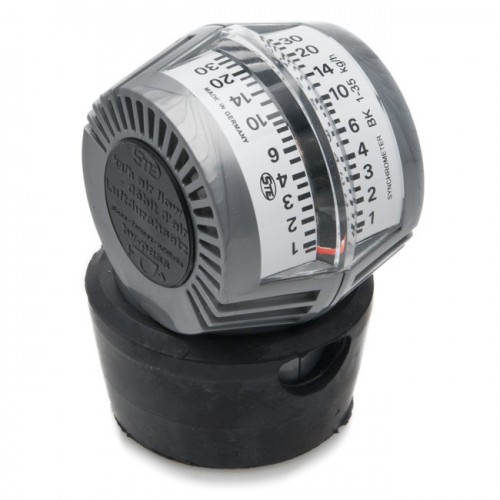

9)  Unisyns are not a good choice for syncing the carbs.  When placed against the carb they also cover the breather which alters how the carb runs.  This tool works well:
https://www.holden.co.uk/img/090_033L.jpg/prod_large
