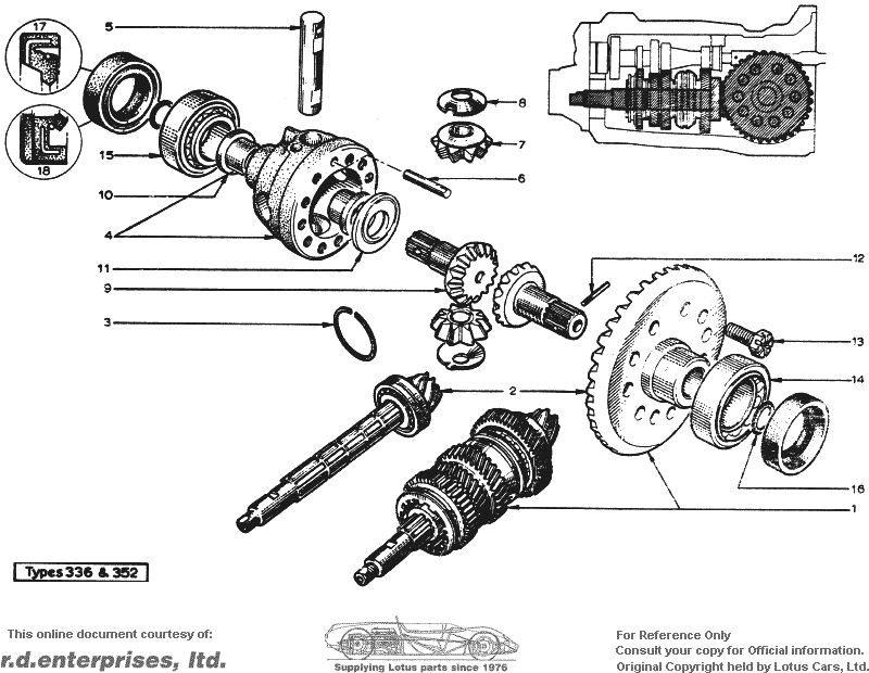

Typically there is NO perceptible axial play on the output shafts.  You have a lot of play.
Have a close look at the image you posted with the arrow to the diff.  The arrow points to the diff side and spider gears. Immediately to the left of the left side gear is the shim which controls the output shaft's axial play.  Here's another image:
http://www.rdent.com/manuals/europa/tcparts/transmission/FM.gif
The diff housing (incorporating the ring gear) is a solid assembly.  The external nuts set the ring gear's position and bearing preload but would have NO effect on the output shaft axial play.
The shimming people are talking about is the placement of shims between the pinned half-shaft yoke and the collar which the seal runs against.  The seal collar presses against the very large diff housing and its bearings which have no problem carrying the suspension's loads.  Without these shims, the suspension load goes to the internal side and sider gears.  These are not up to the task and quickly wear giving the excess axial play you are experiencing.  The play develops first, then complete failure.
Myself, I would remove the transaxle and repair the problem.  This may involve just replacing the diff side gear shim, or fitting another unworn diff housing.
Mr E. TC is suggesting that you properly shim the half-shafts.  This will correctly apply the suspension loads to the diff housing from the internal gears.  The internal shim/housing/gears will not get "better" but they will stop getting worse.  This may be worth pursuing and provide a lasting fix.  Unfortunately it is impossible to know for sure without stripping the transaxle and checking the diff's condition.
So, now it is your decision which way to go.

OK, to my mind its the shimming of the output shaft on the gearbox. In looking at the video that is your issue (assuming you have not shimmed the driveshaft yoke onto the output shaft but just fitted the roll pin, if you have shimmed correctly then its gearbox output bearings and the box has to come out)
The splined gearbox output shafts do have end float as the output bearings ride on the diff crown wheel which control the crown wheel backlash and bearing fit. The splined output shafts are a clearance fit inside this crown wheel housing and will have backlash from the internal differential gears.
IF there was no end float on the gearbox output shafts the shims would serve a different purpose. i.e. after fitting the roll pin there could be a gap behind the driveshaft yoke and the gearbox and you would feel no play. THIS IS NOT THE CASE! there is end float on the gearbox splined output shaft which the shims take up to ensure any load is taken on the output bearings and not on the internal diff gears and the roll pin and allow excessive driveshaft play, all of which are bad....very bad...
When fitting the shims follow the manual.
However, if after shimming the yoke onto the output shaft properly you still have float then its must be in the gearbox output bearings, which if this is the case you will find vertical movements too as these bearing are tapper bearings
hope this helps

Generally diff side gears and spider gears are set up to be a "stiff" or "snug" fit.  This means the diff gears will be a bit stiff to rotate (not the diff itself, but the internal gears).  This will wear into a nice fit with minimal drag, good tooth contact, little stress to the gears and shafts and hardly any play.  In and out play as shown in the video means that gears are moving around under load and during load/no-load transitions.  The gears are under going considerable stress and tooth contact is not ideal.
In Europas this is caused by incorrect half-shaft shimming.  Instead of the suspension loads being applied to the large tapered roller bearings supporting the diff housing, the load is going through the diff side and spider gears first.  They were not designed for these loads and they will wear and fail.
Now the question is: Can he get away with just shimming the half-shafts correctly?
I don't know myself though, again speaking for myself, I would open it up and repair the diff.
